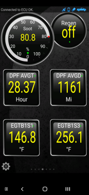

The truck measures differential pressure across the DPF and will initiate a regen when it hit s certain point. It has no idea that you are driving on a cross country trip or just going to the 7-11.
I have a couple gauges set up in Torque pro so I can see when the next one will occur.
When the gauge in the picture I have labeled soot get's to 100% the regen will begin and the regen gauge will go to On and the EGT will rise.

I've tried using torque lite before, but never really got the hang of it. Didn't want to pay for something I won't use. I really like that soot% gauge though. At least then I would know it's coming up soon, and could plan for it happening. What input did you use to set that up? I'm wondering if I could do something similar with the OBDlink app, or if I'll have to jump into torque and finally learn it.

You have to manually create/enter those PIDs, they are not there by default. Here is the PID info
For the soot it's. (select a dial for the widget or digital if you just want a number)
PID: 018b
Long Name: DPF Status
Short Name: Soot
Min value: 0
Max Value: 100.0
Unit type: %
Equation: (C˟100)/255 ....Note, the character after the C is the "times" symbol, not an asterisk
Header: Auto
Regen status. (select a on/off widget)
PID: 018b
Long Name: Regen Status
Short Name: Regen
Min value: 0
Max Value: 2.0
Equation: BIT (B:0)
Header: Auto
If a field isn't listed about just leave it blank or whatever it is defaulted to.
