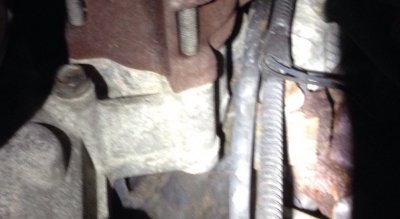

I topped off my radiator in my 05 ram hemi and took it for a ride to get it up to temp. Got home and popped the hood and with my flash light I noticed a little bit of steam coming from the area of I think the power steering pump. It smelled like coolant. I don't know how long it's been doing it I've only had the truck for 1 year now and never noticed and leaks. It's coming from the under that bottom pulley. Any ideas. Here's a pic. ImageUploadedByTapatalk1420845309.315912.jpg

It appears to be coming from the bottom side of the power steering pump. Even with the coolant being low it has never ran hot.

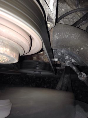

I just noticed there was alittle wet spot by bottom bolt on the power steering pump before and now it's dry. Is there coolant that runs through the power steering pump? ImageUploadedByTapatalk1420846961.816830.jpg

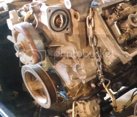

Its likely coming from either the water pump gasket, thermostat housing or radiator hose since these are all located directly above the PS pump. If it looks dry up around the thermostat then I would make sure all the water pump bolts are snug, especially the ones labeled 8 and 9 in the pic.

What is the part in this pic with the 3 bolt holes with the big hole!? Dose coolant pass through that? Thanks

I did notice that everything looked dry around the t-stat housing and the one labeled 8 & 9. It was damp around the bottom bolt hole just below the big hole in your pic.
That is where the PS pump bolts onto the front cover. Could it be PS fluid? The clamp where the line attaches to the PS fluid cooler is known to leak and run back towards the engine via the outside of cooler line. If its coolant then I'm not sure where else it could be coming from.

There's nothing in the cavity, its just hollow. Can't remember if its hard to get at those bolts plus mine was all taken apart at the time. Maybe look up where the cylinder head meets the block and see if its leaking up there. Have you watched for leaks while the engine is running?

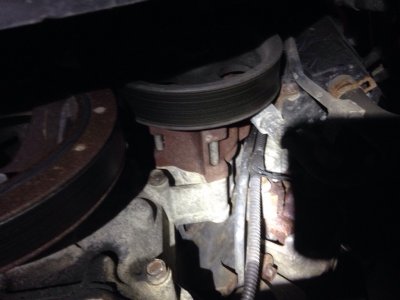

Solve this? Guess where mine's leaking from...
squarebit
Mar 11, 2015
Changed the pump, which showed a little leakage between bolts #8 and #9 and had some play anyway.
A drip is still forming at that bolt.

It most definitely is coolant. Brand new pump now, no leaking around it. I've found numerous threads on the Internet complaining of this, but nobody ever solves it.
Reports of people changing the timing cover gasket and it still does it.
Does that bolt go into a coolant passage?
