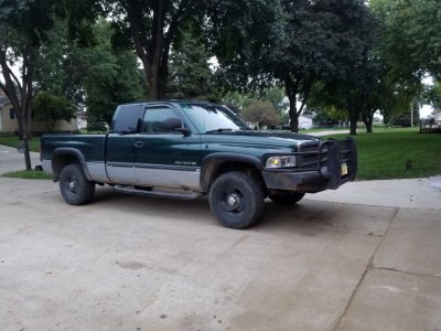

Model it similarly to the ranch hand. Leaves a good platform for a winch and a good approach angle
