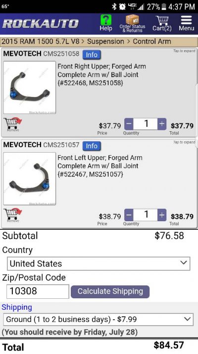

I just did the bils at 2.8 and used the mevotech UCAs
Sent from my SM-G935V using Tapatalk
swh822
Jul 14, 2015
223
168
Rockauto

I can't say how they compare to the high dollar brands ( maybe someone else will chime in ) but I can say they are solid and a better quality then the stock on my 2015...just put them in last week with the bils, did about 400+ miles since alignment and the truck feels good if not better then stock..

They have a quality ball joint but don't re-position it for the lift angle like expensive control arms.

Do the Zone control arms reposition the ball joints?

Yes they do.. The zones are amazing.. You have to hold a set in your hands b4 you will understand the difference between mevotec and zone.. No comparison

Just ordered my Mevotecs. Factory joints were making a popping sound over hard bumps and sharp turns.
