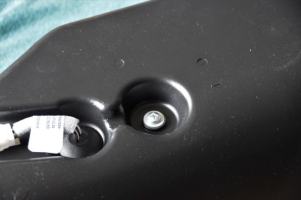

Once the box was out, I removed the screws holding the Alpine with a Torx T-25 screwdriver. I also had to remove the Phillips-head screw that was anchoring the sub to the box.
The next step was to plug the anchor hole. I used Kilmat sound deadening.

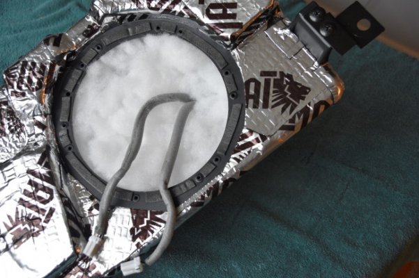

Then, I wrapped the entire box with Kilmat. If I said this stuff was enjoyable to work with, I'd be a liar. I also stuffed polyfill inside the box.

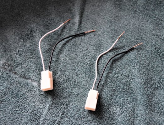

I created a "crater" in the polyfill and and cut the spade connectors off the Metra harnesses.
I connected the Pioneer sub, placed it in the box and headed for my ride. Here it is installed. This model lined up with the factory holes and there was no drilling required at all.
