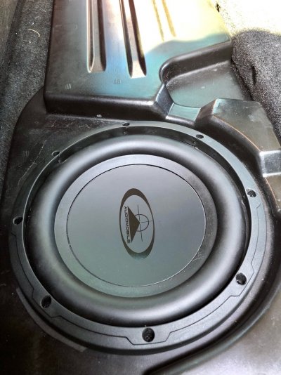

Doing the audio upgrades in phases (as money allows :hidesbehindsofa:)... just got phase 2 completed!
✅ Phase 1:
- Replace factory 8.4 U-connect with KENWOOD eXcelon Reference DMX1057XR head unit.
✅ Phase 2:
- Replace factory 8" Alpine subwoofer with Audiomobile EVO 2408 D4 8" subwoofer (designed for compact + IB enclosures).
- Yank out the factory enclosure and treat the inside with sound-deadening mat / fill with polyfil to trick the sub into thinking it's in a larger enclosure.
- Introduce / install new AudioControl LC-5.1300 amp to power ONLY the new sub (for now, I will use the other 4 channels later on in Phase 3!).
- Install sound deadening mat in all 4 doors / back wall of the cab.
☑️ Phase 3: (future date)
- Replace 6x9's in rear doors / hook them up to my new amp for power
- Replace 6x9's in front doors (with components!) && Replace 3.5" mid's in the corner dash / hook these all up to the new amp for power
Which leaves the other speakers in the truck... the center dash and two in the headliner in the back of the cab... I have decided to keep my factory amp hooked up and powering these speakers... TBH, I don't even know if I'll replace the speakers as of yet. IMO -- they actually sound decent (to me). My new head unit is STUPID crazy at having the ability to tune all of these speakers... so I'm able to get the sound juuuuuuuuuuust how I like it!

OK, now that I've tuned the audio to my liking and have been driving around with the sound deadening mat and the new sub installed (pushing ~500 watts RMS) -- I'm blown away with this small, but MIGHTY subwoofer by Audiomobile! This little thing thumps! Highly recommend this setup if you're looking to keep "factory" as much as possible (I didn't want to lose the fold-flat floors!!!)

@BrBlack -- sorry for not getting back to you sooner... just getting home from my sabbatical (for the month of July! emotions33.gif) and settling into "life" again. LOL!
Anywho, some answers to your questions:
1. My installer just poked the new speaker wires (from my new amp) through a piece of the sound deadening mat I put all over the inside of the factory enclosure.
2. I just told him to use whatever he had in the shop to block off that hole... it looks like he just used a piece of aluminum tape -- seems to work well :shrug:
3. The sub is still in it's factory location (rear / passenger side) under the seat (I still have my fold-flat floors!). My amp is located right under / behind the same seat (rear / passenger). While it _is_ a little tight back there... I don't see having any issues with air movement. The amp gets warm for sure... but -- everything seems to be working very well (so far). I have used amps in tighter spots and have never had issues -- so I'm hoping I won't have any with this setup either !
Snapped a few pics for ya too... in case that helps!

@BrBlack -- sorry for not getting back to you sooner... just getting home from my sabbatical (for the month of July! View attachment 525980) and settling into "life" again. LOL!
