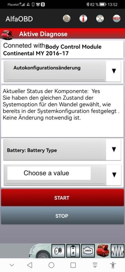

Ok, no big deal, got Alfa OBD in the meantime and could change the language of the dashboard with it (was not working in the settings, thing because of the big Android screen).
I just found that you can set the correct battery in it, sorry I switched it to German, but in the dropdown below "battery type" it asks for an Id and I was not able to find a list for it:
Any help would be really appreciated.
Another interesting setting is this one
I only know this from the Ranger and I am not sure if it´s working here the same, I expect when I setup 12,8v for example that the system prevents the battery from being discharged anymore as good as possible but it will not affect important functions of the car, is that correct?

Basically, it´s this in English
Connected to Body Control Module
In the middle, it´s just saying the current state is yes and did not change anything
The second dropdown where I struggle says to choose the value.
When I open it it´s not like I know it from Forscan like 95AH - 12v but ID1, ID6, and such stuff.
I assumed that there must be something behind the ID numbers (12 (??) if I remember it correctly) and that choosing the correct one will have some benefit for the correct load off the battery (for example).
______
IBS voltage setting is still like "what does it affect", is the sensor itself just not working below the value you set or is it affecting the battery discharge.
One mentioned in a forum that his battery was discharging to much and he just played around setting it to 14V and now his batters stays at 13,1v all the time not discharging anymore.
Could not make sense out of this:rolleyes:
