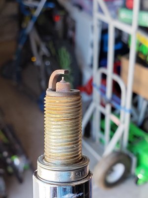

You can push it past 100,000 on a stock or bolt-on truck with iridium plugs. My truck is a 2015
Save the $130 unless you have a 2013 or older that had copper plugs.
This is my first time dealing with iridium plugs. I had always believed in copper since I did lots of drag racing with the SRT4. Since I was always pushing that 4cyl I went through quite a few plugs.
For the Ram the iridium plugs either work or they don't. Even at 100,000 I don't think any of the 16 plugs lost gap.
They all measured with .043 - .044 which is acceptable room in error.
I would recommend saving the money on plugs unless of course you're running a nitrous or boost scenario.
I hear what your saying, i respect your experience and i dont mean sound like a **** but yea they still look good but the point of service intervals is to prevent failures before they start and $130 every 100k miles is completely acceptable in terms of prevention. IMO anyway.
I know Mainstream iridium intervals are crazy wide, between 60k-150k but not all vehicles are built the same
Well said I appreciate the opposition. I think your opinion versus mine should help readers make up there minds on changing out spark plugs.
As a test not that I would personally do it but I'd be curious to see how long 16 iridium plugs last till failure. The plugs I presented have 100,000 which to the experienced eye realizes you could still get more life out of them. Depending on how frugal you are of course.
