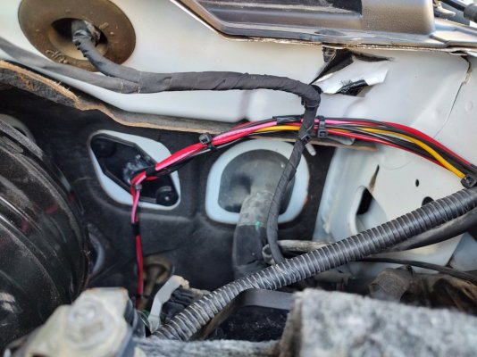

I started with a subpanel off the main fuse block to power the cameras and the DVR. I wanted to have the cameras turn on with the ignition, but not wire them from the ignition or some other non standard way. I also have an Airlift system installed and needed the subpanel to run the compressor.
Three wires (12+, 12-, 12ACC) for the cameras run through the clutch blank plate to a relay under the dash.
The other wires running down the firewall go to the Airlift compressor.
