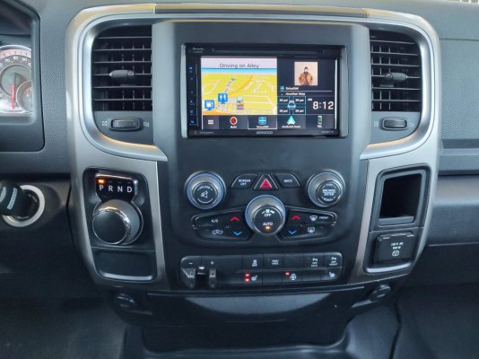

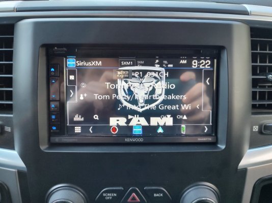

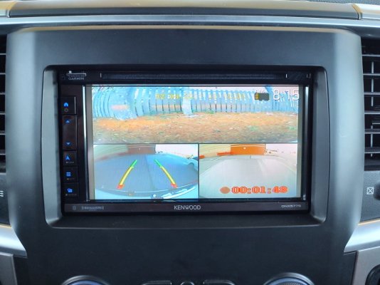

I finally got around to installing my Kenwood DNX577S into my Ram over the weekend. Got to say I am very happy with the results.
I used the iDatalink Maestro RR2 kit with the Scosche dash kit. I also reused the factory GPS and Satellite antenna with success
The other upgrade is the addition of front and bed cameras with a DVR system.
Lots of parts and wires shoved in the center stack, which was the biggest headache. I was shocked it all fit.
Let me know what you think.

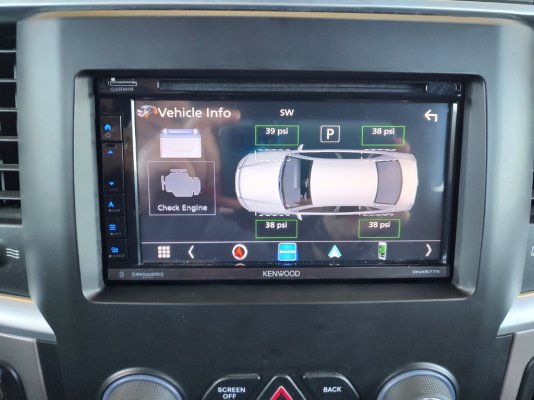

Vehicle Status Screen. I need to adjust the depth of the head unit in the dash. It is sitting about 3/8" too deep.

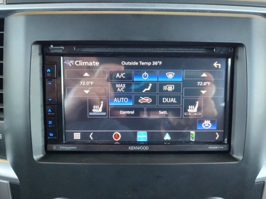

Retention of Climate Control Screen
Camera DVR Screen

That looks pretty good!

Very nice. I agree pulling it forward a little for better clearance on the side buttons.

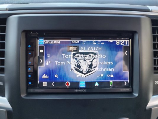

Thanks for the feedback!
I got the head unit depth corrected and the buttons are much easier to depress now.

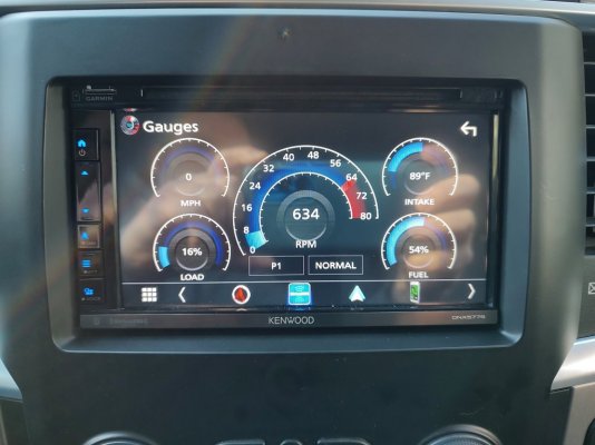

Gauges also work without a connection to the OBD2 port or the can bus.
I found two images I am using for the background. I'm partial to the blue one.
I bought the URAM USB hub in hopes it would work with Android Auto. No luck.
I'm going to remove this and run a USB 3.0 cable through the seat and to the Kenwood.

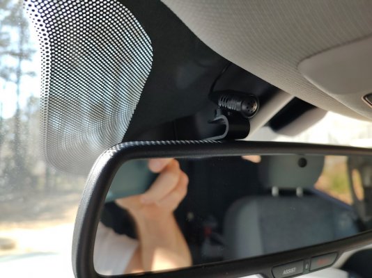

I have the dual Uconnect mics in the headliner, but these will not work with any aftermarket installation. You must use the microphone supplied with the aftermarket head unit. :mad:
I mounted the Kenwood mic to the top of the mirror and routed the wire through the inside lip of the headliner, down the "A" pillar and then through the dash to the center stack. Removing the "A" pillar is very easy; remove the two 10mm bolts behind the covers and it pops off. Not pretty or what I would have liked, but it is what it is.
