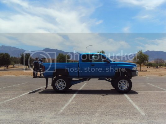

does anybody make a 8" suspension lift for a not so expensive price? here is a picture of my truck as it stands. i want to go 8" so that i can rock some 38" tires.

If I go any higher I don't think I will fit in my parking garage at work. Now if the right deal came around, then I might consider it.
Also that blue truck is 14" all suspension
