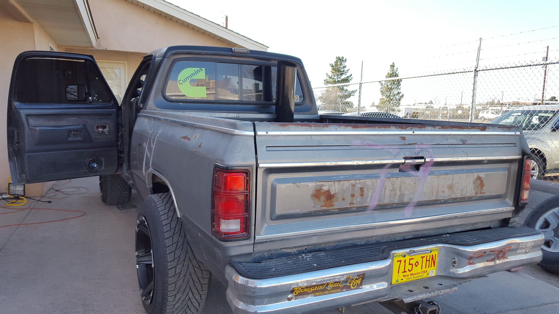

This is my 1st gen cummins short bed
[IMG][/IMG]
