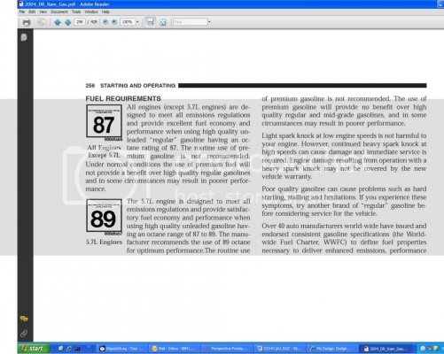

If your engine is not built (internally at least) then putting 93 octane in your tank is a waste of money. You may see a couple extra MPG but its not worth the 30+ cents per gallon your putting in. Your truck is made to run on 87 Octane, keep using 87 and save yourself the money.
93 octane is for high performance...... 4.7L is not a high performance engine unless you put plenty of money into it. You will not detonate with 87 octane, so honestly thats what you should be using. If you tune your truck to a 93 octane tune and you go into sayyyyyy Arizona, where we dont have any 93.....what now??? Better have your tuner on you or a lot of octane booster.
There was an article/test about this, I will have to find it then post it. Pretty much your truck is made for 87 octane, putting 93 will not increase power output.

This is from the Dodge Ram owners manual.
