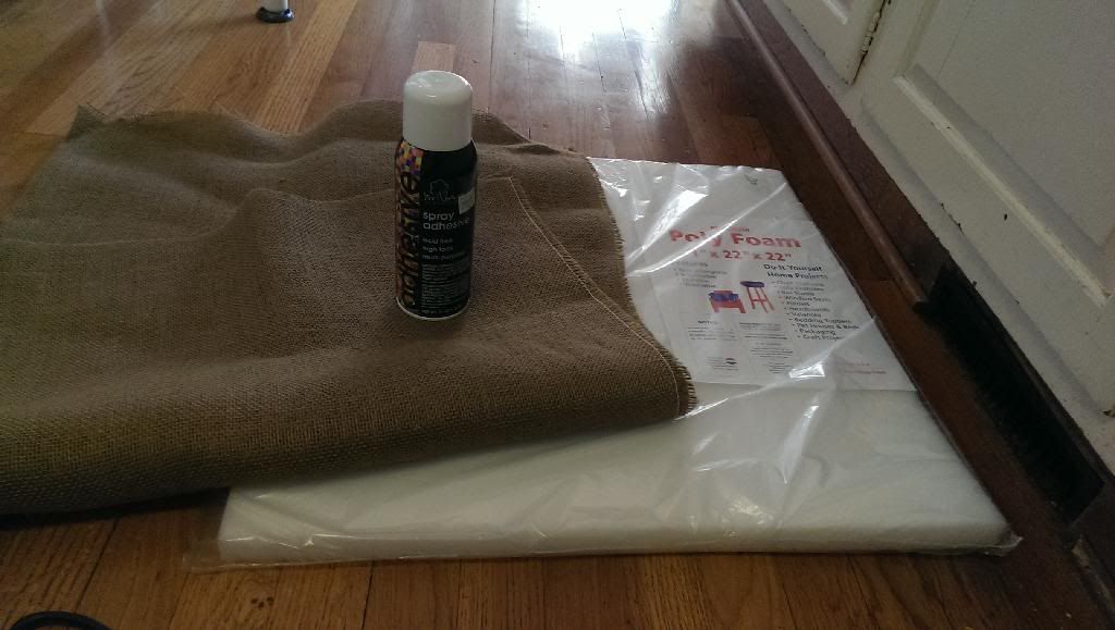

I purchased a "new" foam padding and seat cover from another forum that was parting out a truck
I then went to Hobby Lobby and bought some 1" foam, spray glue, and a yard of burlap.
What creates the holes is on the seat frame there are welds that have very rough bungs, that with the friction of you climbing in and out, wears through the foam creating the issue.
The first step then was cutting the burlap and gluing it to the bottom of the foam padding, giving the foam a protective layer between it and the seat frame.

I used the 1" foam and cut the shapes of the pads on the seat. (You kind of have to wing it, as there is no really easy way to trace them.) I just measured them and cut and trimmed until the were pretty close. I used a utility knife and a hot knife to cut the foam. Then use the spray glue to glue the new foam on top of the foam padding.
