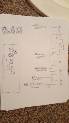

I have A 1999 Dodge ram 1500 st. Manual everything (doors, windows) so i dont believe there are any antitheft systems on the truck. I believe i have drawn up a diagram that will work for my truck. Just wondering how to bypass the key mechanism on the steering column (locking wheel). I attached the diagram below. If it looks incorrect or correct please let me know. Thank you! I plan on making the switches in to a domino effect (one must be on before the next) so if the main kill switch faults i can kill it with one of the previous switch. I plan on making the main kill switch just a simple turn key mechanism that way i can take the key with me. Kind of defeats the purpose of what im doin, i know, but im changing the style of my truck so this helps the interior aspect. Thank you in advance!
