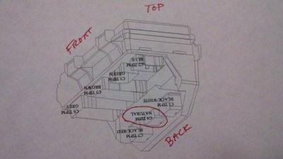

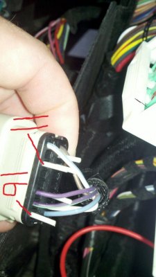

This is where I got hung up before.... Unclip the fuse box so you can see the plugs on the bottom side. The plug you will be looking for is in the middle on the bottom. It will have a red lift tab and the plug is a light grey/beige color. You will need to pull this plug out (lift the red tab and gently wiggle the plug off). you will notice little plastic tabs in some of the holes where wires are not present. To remove these and to place your fog light wires, you have to remove the bottom of the plug (opposite of where the individual wires plug in). The bottom looks like it separates the connections so they do not touch. The plastic plugs can be removed from here. You are looking for #11 and #16 positions for the fog lights. The jumper cable connections fit perfectly in here if you used the MOPAR jumper cable. Replace the cap, and put it back in the fuse box. Secure the ground to the ground near the fuse box on the fender, and put the fuse box back in place.
