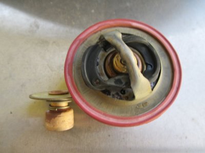

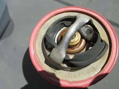

Alright guys just ordered the flex a lite 183 fan today will be installing his week as soon it arrives. For those that have done this mod did you also replace the thermostat to a 180 degree? And what startup temp is a good setting on the electric fan with a 180 thermostat. I live in southern Arizona I see mostly very hot weather. Right now I have a 203 oem tstat however I found this thread on ramforumz where someone did a write up about using a 2003 Hyundai 180 thermostat and simply adding a rubber gasket from the 203 stat. I found this to be a neat mod thread because going this route would mean buying a $12.99 thermostat compared to $35 jet performance thermostat. Heres the link to the thread:
http://www.ramforumz.com/showthread.php?t=92023
