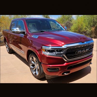

Thanks for posting the build sheet! I hadn't seen it before so that was fun. I still can't believe this truck was sitting on a dealers lot on my way home from vacation as it is exactly what I would have put in for my custom order. I like the look of your night edition and would have preferred that, but, I couldn't have gotten the sea salt seats. I wanted the lighter color seats here in Arizona. I like your theory about the factory putting the 22s on. I'm pretty sure that if the dealer knew he was selling me 22s our negotiations would have started out $2000 higher.
I do love the looks of my rims. I'm just afraid I'm going to be exploring some dirt road some day, come across a washout or rocky area, try to cross, and regret it due to these narrow sidewall tires. Have you done any off-roading with yours? I feel like with this setup I could damage the rim just by hitting a curb too hard at the wrong angle.
Anyway, I'm seriously considering putting 18" Ram Rebel wheels and tires on. I think they also look pretty good and, at 33", would give me much more sidewall and maybe an even smoother ride on the highway without adding any unsprung weight. Although, I really can't complain about the ride with this setup. I guess the other option is to get a lift and 35x22s. Since most my driving is on the highway I'm just not sure I'm willing to give up the MPGs.
Your request for a picture prompted me to update my profile. Thanks again!
