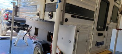

Experimentation time! Just pulled the camper off. I haven't really driven the truck without it. I'm going to see if what I'm feeling truly is the camper weight or just the dynamics of a straight axle 3/4 ton truck. I am pretty confident it's the camper, but we shall see.

Experimentation complete! The truck actually rides better with the camper, especially the rear end. The front end, no change really, the rear just seems more leveled out when hitting bumps. I really think weight in the rear helps control the ride. ....however, much can be improved. I think a full Carli setup is in my future....
