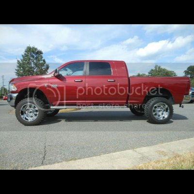

What does the kit use for the rear? Is there a block/spacer for the rear or a longer spring? Also did you get longer shocks for the rear. If there is a spacer used in the rear you might be able to find a taller one. I know many kits come with a 3 inch rear, which give your a leveled lifted look. There are companys that make a 5 inch.
holy cow theres a 6 inch block back there! I would double check that, Im almost 100% certain its only a 3 inch block with the Procomp kit. I cant remember who makes them but someone has a 5 inch block for the rear.
Usually its 6 inch on the front 3-5 inch on the rear. So you just need to measure that block you have to confirm, then find a vendor for the height you want. Easy as pie, thats how.
Good info thanks. I had a look under there and it looks like a 3" block with 3 sections of leaf springs adding up the rest. Is that normal?Answer this on the other forum as well. But yes your truck should have a 3" block in it with the 6" ProComp kit so you could easily swap to a 4" block. Either BDS or Top Gun Customz would be a good place to grab them.
Yup, the 3 steel spacers under the leaf are on there stock and attached to the leaf spring. The block sits underneath that and is simply held in with pins and the U-bolts.
Yep good old leafs. My "14 has the coils all the way around and I can't tell much of a difference. Just emailed Top Gun Customz to see about their 4" bock.Oh yeah that year still have leaf springs! Find a bigger block, make sure its angled to keep the pinion right.
