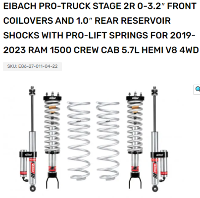

Hey all. New to the forums. Long time follower, first time posting. I know there are lots of threads about leveling kits and which brands are great/ok/crap, but I'd like some feedback on 2 specific brand's kits. I'll be doing a leveling kit (coilovers, coils, and shocks) and tires when I get back from deployment, but I can't seem to get a solid answer on the FB pages I'm a member of, so I figured I would come here and get your opinions since you all know a lot more than I do. lol.
So, Bilstein has 2 kits (5100 and 6112) and Eibach has their 2 Pro Truck leveling kits (Stage 2 and Stage 2R). All are comparably priced. So, my question is, which kit would you all recommend? I plan on doing some light trails, have a camper shell, and light to moderate towing a few times a year. I also plan on getting some new UCAs with the kit. I found a set of SkyJackers online that seem reasonably priced.
I plan on reaching out to Nick@GotExhaust to order the parts since everyone on here speaks highly of him and his company. ^_^

Both are a nice upgrade over stock. Both will have very nice ride comfort on the road and will perform better off road. The 6112's will ride a little stiffer than the eibachs. I will give the Eibachs the slight edge with on road ride comfort. However the 6112's will perform off road a little better especially with their slightly larger shock bodies. So I will give the 6112's the slight edge there. Neither option is a bad option.
As for the Skyjacker UCA's, we havent had a single person ask for them so I do not have anything to report on them but if you want them we can offer those as well.

Do you think the 6112's would be better for towing as well since they would be a bit stiffer? And what are some UCAs you would recommend? I just picked those because I cant afford to spend $800+ for a set of Icons and I keep seeing people on this forum saying to avoid RC products. Or, do you think I would be fine running the stock UCAs, since any of these kits would only give me around 2" of total lift up front?
The real help for towing is the rear suspension. The front does aid it a bit but not nearly as important as the rear. The larger bodies of the 6112's and them being firmer overall does make them a little bit better suited for towing. If you plan to go over 2" of front lift/level I recommend UCA's. I would recommend the Zone UCA's. That is the most common option option here. They are angle correcting and much stronger than stock. They are a little more than the skyjackers but much cheaper than the icons.
