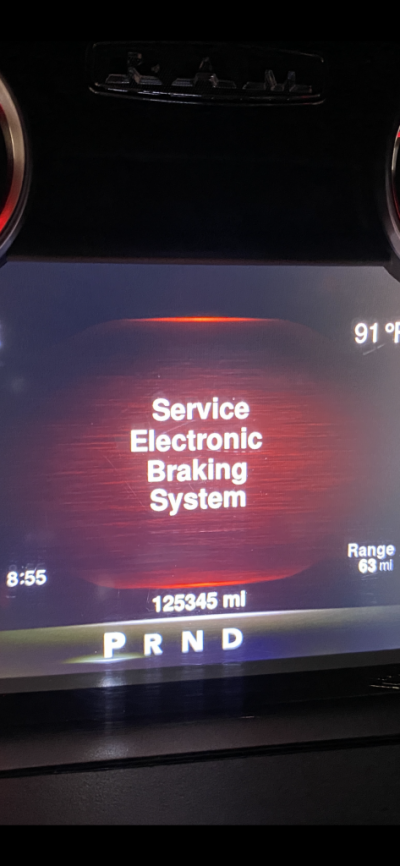

I recall reading some threads last year about the issue I'm having but can't find them anymore. My 2016 Ram 1500 Sport has 125,000 miles on it and has been the perfect truck up til the day I bought Yukon Denali, literally the next day my Ram decides to not start (dead battery). I replaced the battery and alternator as both came with the truck when I bought it 4 years ago. Nothing. Still dead the next morning. A few days later I went out to move trash cans to the street and noticed my dash lights were on! I couldn't do anything to turn them off except disconnect the battery (alternative would be to pull fuse). So I did this routine for a while before taking it to the Ram dealer. I explained that numerous people post on this issue and I have yet to hear of anyone actually getting it permanently fixed. Seems like they try updates, replace modules, replace wire harnesses and in the end the customer has the same issue. Well, now my Ram has been there for 2 months. Nothing they've tried has worked. I reached out to "Ram Cares" in this forum. They wrote back and said due to the mileage and year there's nothing they can do to help, stick with the dealer and see what they come up with". Today I reached out to Fiat Chrysler's customer service. They have assigned a case manager and should get back to me in a day or two (supposedly). Can you guys that have been through this give me your stories and outcomes? If you're currently going through this, maybe we can trade notes and help each other speed it up. 2 months is ridiculous. I refuse to bring the truck home until they can show me it sits there for more than a day w/o having a dead battery. We live 45 minutes from the service center. Thank in advance! Attached is one of the messages I started getting infrequently after the problem started. I sent that to the dealer with no feedback. I told them to start with the electronic brake module and go from there, guessing it didn't work.

UPDATE: After 105 days at BlueBonnet Ram in New Braunfels they claim that the issues with my truck were related to an aftermarket alarm keeping the canbus from going to sleep. I had them remove the alarm system (it was installed by previous owner). The dash lights are no longer staying on all night but still turn on periodically for a few seconds throughout the night then shut off. Other things I noticed are; the first few nights, the headlight control knob did not function. Meaning, if the truck was running and lights were on, you could not turn them off or switch to just parking lights. Every time you open the driver's side door the headlights shut off until the door is closed. I tested all 4 doors, only the driver's door does this. Then on a dark road heading home at 5am traveling at 70mph all lighting shut off for about 3 seconds, beeps and messages started popping up in the display. After 3 seconds it all stopped and lights came back on. 3 days later all issues went away and a new set of issues popped up. Now when the driver's door is open, the parking lights turn on then turn off when the door is closed. Headlight control knob works again. Last night I had no issues at all. Everything worked, no weird issues when opening the door, no issues at all! I doubt it will stay this way. The charge was $700 for the electrical diagnosis, removing the alarm and replacing the psgr side manifold bolts. Considering trading it in before more symptoms start. Oh, and extended warranty would not cover the repair due to the alarm being aftermarket, despite it being installed prior to my purchase....
Can/Bus system diagnosis is the bane of many automotive technicians. The very expensive equipment necessary to properly make accurate diagnosis and repair isn't owned by many guys in the trade. The entire concept is beyond the norm on automotive applications.
Shane Allaire
Shane Allaire
Nov 5, 2018
San Antonio, TX
True but you think the actual Ram dealer would have this equipment. Then when FCA got involved on the corporate level they should have made a judgement call to send the vehicle to a dealer that did, if in fact any do. My trusted neighborhood mechanic could have done the steps they took but in 5 days, not 100 plus days that the dealer took. The whole experience was a mess and rather than wait for the next electrical issue to surface, I abandoned ship and sold the truck while it was functioning as it should. It was a hard decision to make as I loved the truck. Minus the electrical issues, she ran better than any other truck I've owned. Too many folks with the same issue reported the problems resurfacing weeks later. I didn't want the headache...I wonder why there aren't technicians that specialize in just this area of can/bus that float around between the dealer repair centers?
