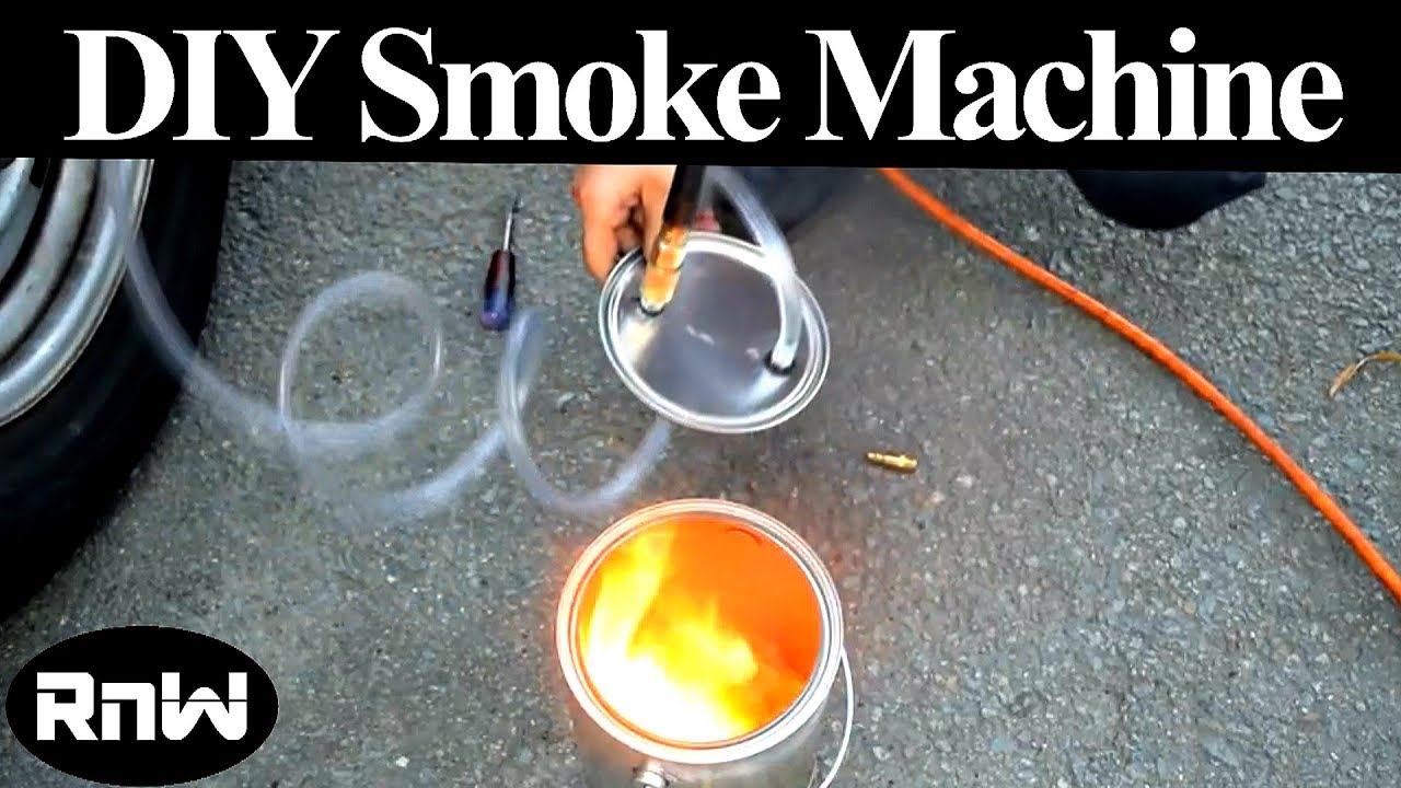

If the Hoses are cracked or torn, you can check the hose right at the ends with a visual check, otherwise the Smoke Test is an alternative.
