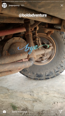

It broke on this. Does that look beyond the range of motion?
It's just a weak ****** design. Folds over like a pretzel.
I sure hope you're being facetious. Because on your own post you mention rock crawler.
It didn't just break because it's a ****** design as you claim. :flipthebird:
It is a ****** design. And booger welding the adjustment nut is a ****** fix.
:flipthebird:
You can see it’s bent after the adjuster. That was most likely from an impact like dropping a wheel to hard.
Dropping a wheel? What does that even mean?
This is it, bent. All it took was force. I'm not actually the only guy who has had this happen. If you go over to the PW Registry, this has happened a number of times.
I know it's not a problem for you guys at the mall.
My posts are to emphasize, that if you are spending $300 you might as well buy a superior product and go aftermarket and attempt to get RAM to pay for it.
Or make nonsensical arguments with me. It's your time and money.

Dropping a wheel as in the picture that you first posted where you’re trying to cross a bit of a crevice. If you go in to fast wheel drops into the crevice, and if it hits something hard you can cause damage.
Ive seen similar things happen a lot, same kind of damage happens when people hit a curb.
If you do lots of off roading, ***** gonna break. Not necessarily a ****** design, but if you do a lot of off roading you’ll always find the weakest link in factory components, and eventually upgrade them.
Vehicles like the power wagons and wranglers have to compromise, people want them to do everything so naturally they can’t be way overbuilt for off roading and yet still be affordable and a daily driver.

im with ya brotha. reminds me of the ******* that puts a 4' cheater on a wrench then says the wrench is ************* when it breaks. cant fix stupid. if the draglink was 2" DOM tube somebody would still find a way to bend it and talk ****
