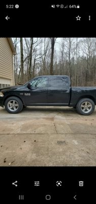

Finally got around to installing the supreme Suspension 2.5 level kit. Wanted to post pics for those considering it.
Front passenger/drivers- 36.75/37 inches from ground to top center of fender.
After passenger/drivers- 39.5/39.75.
Also finally got rid of the stock rubber and went with 275/65/20 Nitto Terra Grappler G2. Great tire so farm took about a 2-3 mpg hit all around but expect that to level out a little after the tires wear in a little
