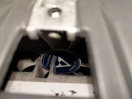

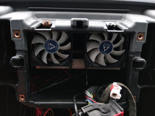

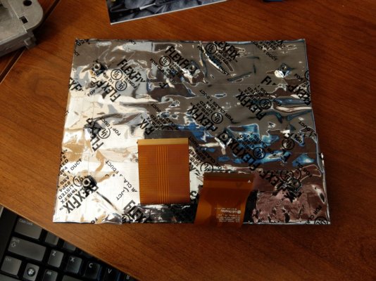

The ghost touches and delamination are one and the same issue. The battery disconnect you did only appears to have corrected the issue because the electronics were allowed to cool. The problem's symptoms come in stages 1 Radio gets hot, 2 ghost touches occur and 3 overheating causes screen delamination. The issue can be "fixed" by keeping the radio cool only during the the early stages before delamination. I added active cooling to mine and replaced the thermal sync material inside the radio with a higher quality thermal pad. It sounds like yours is in a correctable state and it may be wise (if you like the factory setup) to due some preventive maintenance (attached images of fans). You may be able to get away with fans or thermal material and not both, but I did both and also made a heat shield for the screen from motorcycle fiberglass exhaust wrap sealed with reflective foil tape too...2 years with a formerly ghost touching screen without further ghost inputs (except for once when the fan fuse blew).
To test, drive around on a hot summer day with your heat on full. Ghost touches should start again under these conditions relatively quickly.

Can I pick your brain? Where did you draw the power for the fans? Simple 12V DC fans? Fans blowing or sucking? What did you use to mount the fans? Thank you
SitKneelBend
Jan 8, 2015
9,102
4,793
St. Louis
3.6 Pentastar
1. Tapped the cigarette lighter plug
2. Arctic F9 Silent, 92 mm 3-Pin Fan... https://www.amazon.com/dp/B0119SG8X4?ref=ppx_pop_mob_ap_share
3. Sucking away from radio blowing toward engine.
4. Zip ties
