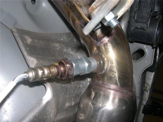

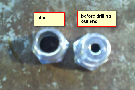

Been down this road....so let me explain, yes, truck will run a LOT better if your cats are even partially fried, I had an 04 that would fall on it's face at WOT, found cats partially plugged, like you, straight pipe was answer, so did......now the negative effect, truck ran amazing after removal, full power restored to the before anemic 4.7, honestly felt like a new truck, mpg rose, low end torque came back and accelerating on ramps like ease.......dodge is a strange beast, they use ALL 4 sensors to set short and long term fuel trims, with semi plugged cats fuel trim tables looked horrible with scan tool, each bank was fighting it's twin.....so cats gone, fuel trims look more even but running fairly rich, motor breaths easier, watch your mpgs and as soon as they dip go in and wipe long and short term fuel trim tables....about once every 2 months for me and she'll run just a tad rich but run fine.......also, the 545rfe trans is a "learning" trans so after you dump cats, do a trans relearn to adjust pressures to higher torque.....yes, you'll get CEL for cat efficiency and possible bank 1/2 rich.....but she'll run like you've never felt her run......also, in a pinch you can unplug intake air temp sensor and it'll default computer to thinking temp outside is below zero and start pouring fuel down it's throat (think track times).......hope this helps, dodge cats suck butt crack
