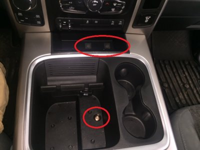

I wont call you vain, I did the same thing. i have some pics below to help if you want. i paid 235.00 for my kit from my dealer, so that sounds about right for what your paying. took about 2 hours to install. the only pain was mounting the Module under the dash, above the gas pedal. it has screws but they are not easy. i just used zip ties, it works just as good.
The kit comes with instructions, but here are some pics and tips.
Pics
1. top red circle, you pop off the plastic tray and there are two screws, the bottom circle is for the console, they are under the rubber mat liner. the third circle is to the right and the screw is in that cubby, remove the liner.
2. the two screws mentioned in the first pic are in the top circle, the second circle is the last screw holding the console in. after removing all three for the console, it lifts up. you'll have to use a bit of force. unplug the charging port and put the console aside.
you can then pull the dash towards you. and start to remove connections
3. its what it will look like with it all removed. then you just swap the blank spot for the controller and re assemble.
4. its where the module will mount, its a beast to try to use the screws but you can try.
hope this helps
