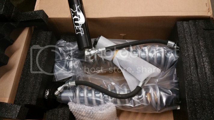

Ordered BDS Fox coilovers

So with your Fox set , you remove the factory coils completely?
Do you reuse any part of your factory coil and spring assy ?
Do you reuse the upper spring seat like with your bilsteins?
What are the height adjustments for the Fox shock ?
LOL SORRY for.all the Q s but I'm really digging those shocks !

Yes you use the top assy part on top and bottom to bolt them in. These replace everything. Springs,shocks,and the BDS spacers.they can adjust up to 2" I believe? Mine are set at 7.5". They come preset at 6". You just turn the ring till you get them where you want. 5/8's turn = 1/2" of lift. Ask away bro. I don't mind at all and thank you. I absolutely love them.

Man that's a fantastic looking truck !
I installed my bilsteins @2.8 and Mevotecs a little over 5k miles ago I'm really happy with my set up , but I'm really digging those adjustable Fox Coilover with the external reservoir!
