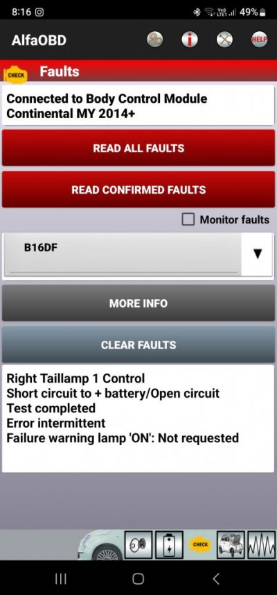

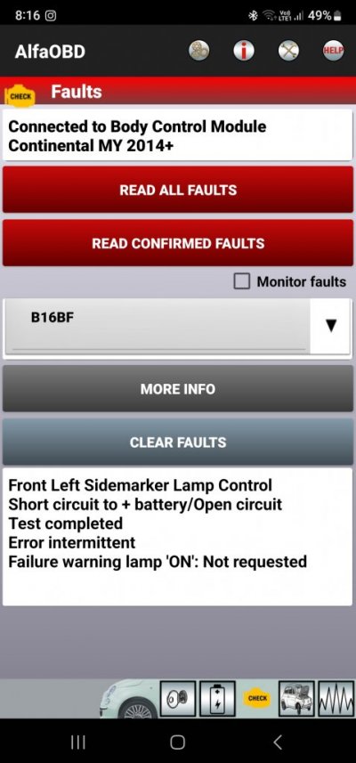

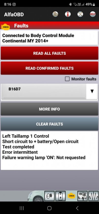

Hello everyone,
I really need help!
Recently bought 2014 RAM 1500 SLT, the owner has swap front headlight from qouad to Projector headlight, and rear taillight with Vland taillight, however he did some changes using ALFAOBD, and as the taillight he installed he shouldn't change any settings as it's direct fir for the halogen tail light but he did some changes which which he don't remember, also for the front headlight!
Error message (Parking light out come everytime I hit the brake or turn signals, only when the lights ON!
I've attached few screen shots of the errors.
Now, I tried to change around few sitting using Alfa, but without any luck!!
Can anyone PLEASE PLEASE help and tell me what is the factory settings that came with the SLT trim? I want to return it to the factory settings and refitted the quad headlights and halogen tail light please.

The previous owner most likely changed the bulb types to LED but that doesn't always resolve the error issue popping up.
It's probably one of the LED bulbs that is causing the grief.
