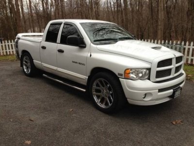

Here are my lowered Rams.. I no longer have the white/black one. I was stupid and sold it.. Still currently have the silver one though. I did keep the wheels off the white one and put them on the silver one.. I like the blacked out look better than the standard polished srt wheels.
Please list tire, wheel, and drop specs on that white one and yes you messed up getting rid of that. I can say for me that the white QC is the best looking QC I have ever seen, SUPER CLEAN!!!

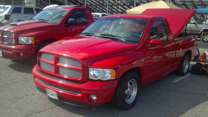

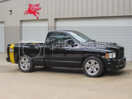

Here is a pic of my '04 Rumble Bee 2wd. It is lowered with a McGaughys 2/4.5 spindle kit/flip kit. I did not use the rear shock extenders and used some Belltech Nitro 2s, stock shocks up front, the rear leafs are in the highest holes in the shackles(lowest ride height), cut half a coil up front also. 275/55-20 tires.

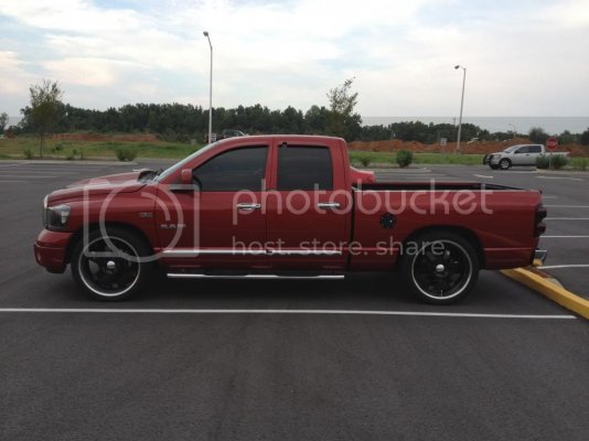

2/4 drop with 305/35/24 on 2008 Laramie. in the pics with the stock 20s in was in the 4.5 setting. these are old pics but you get the idea. i wanted it lowered, but still usable as a truck as i ride dirt bikes and quads about every weekend.

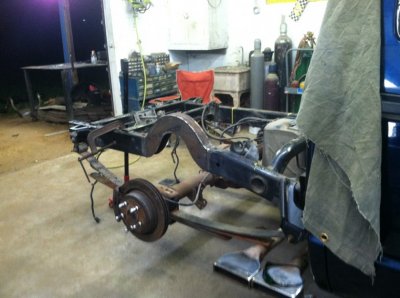

can i play now, setup for 11" of drop in the rear now :)
