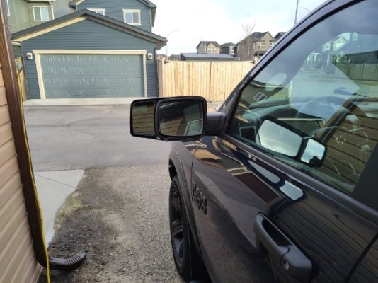

star_deceiver
May 18, 2019
568
965
Airdrie, Alberta
3.6 Pentastar
Snap n zap. $90 Canadian. Fits perfectly. The mirrors are flat so you can see straight back. There's a hole in the bottom to tighten up the mirror if it vibrates. Power fold works as it should. I would have preferred them to be convex mirrors, thought. They are very snug around the mirror frame. quite difficult to get them to that final clip and release. They're going nowhere! 8/10 IMG_20220620_155252.jpg
They are not as good as the flip out factory mirrors, but I wasn't about to spend $1300 for those.
