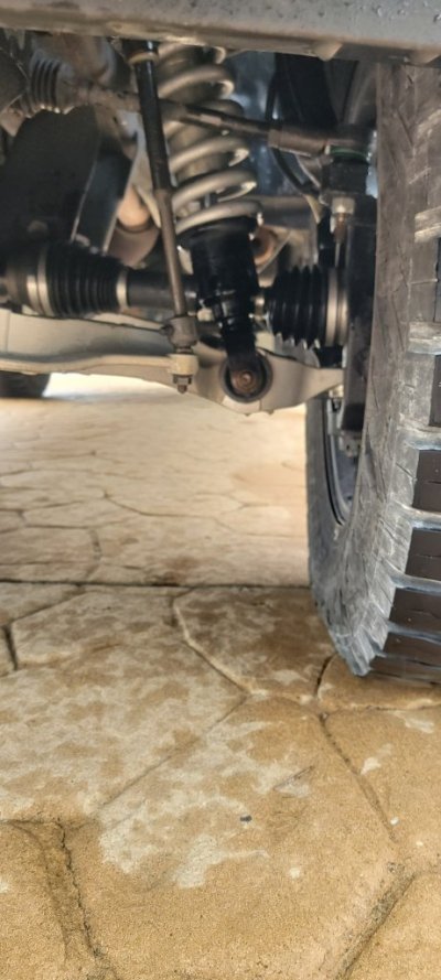

No issues with my fox 2.5 and stock cv axles.

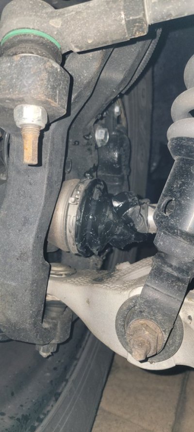

I'm wondering if I should have left well enough alone and kept my stockers. I got a spare set of the Cardone HD, but if I have problems with the trakmotive, I may end up trying oem out. Super hesitant on the Cardone with the grinding away on the coilovers. Is there maybe an install issue I may have overlooked?No issues with my fox 2.5 and stock cv axles.
https://www.ramforum.com/threads/my-ram-ongoing-project.97961/post-2745381
Can you lay them out next to each other, maybe you will see the difference in the stock vs. the Cardone vs. the trakmotive?I'm wondering if I should have left well enough alone and kept my stockers. I got a spare set of the Cardone HD, but if I have problems with the trakmotive, I may end up trying oem out. Super hesitant on the Cardone with the grinding away on the coilovers. Is there maybe an install issue I may have overlooked?
I can already see the difference that the shaft for the trackmotive tapers down providing more clearance.Can you lay them out next to each other, maybe you will see the difference in the stock vs. the Cardone vs. the trakmotive?
To be fair, the Cardone HD only lasted about 5 months with parking lot turns.Told you guys they were Junk

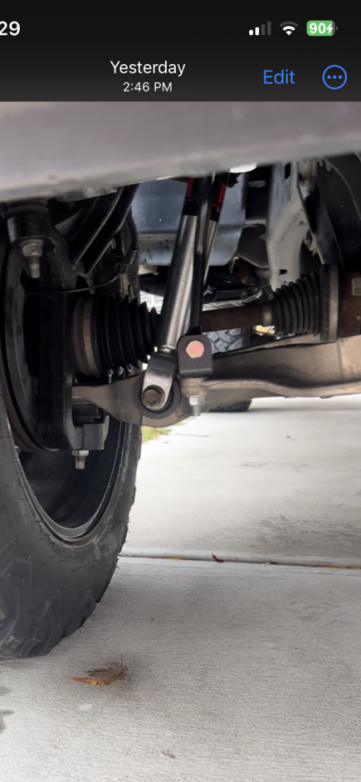

I take it no issues? Looks like oem CV's as well? What struts are you running? I never had any issues with the oem struts and bds spacers.
No issues. And this is oem axels. These are the M1 6” loaded RC shocks/struts. They ride a bit stiffer than stock.I take it no issues? Looks like oem CV's as well? What struts are you running? I never had any issues with the oem struts and bds spacers.
