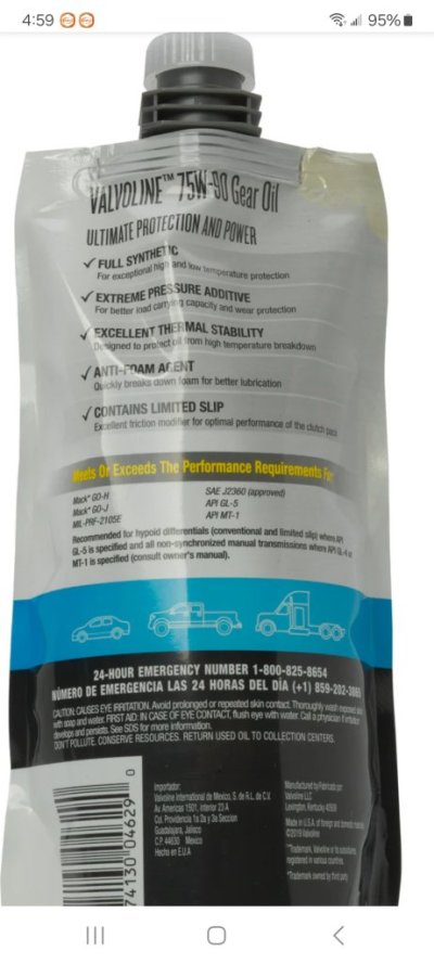

I have a 2020 Ram 1500 Longhorn Limited. The build sheet says I have a 3.21 rear end. There's no mention of it being a Limited Slip Differential. Would there be any issues if the gear oil has a friction modifier? Also, looking to see what brand people have had the best luck with. Thanks in advance.

I like Valvoline in the flexfill containers. No problem with the fiction modifer.
