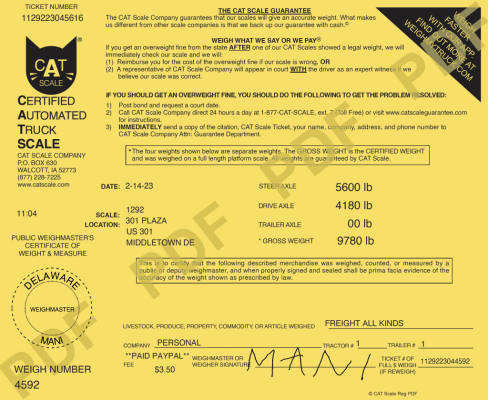

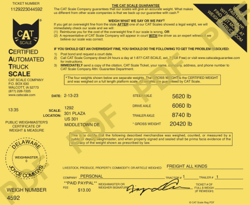

My Bighorn 1500 has an advertised payload of 1820. I spent a lot of time shopping for one with the biggest number on the door sticker. The highest I found was 1741 on the door sticker and bought it, so it didn't have a lot of heavy options on it. That said, I maxed out the truck with a Jay "Feather" camper that has a max weight of 5500. Nothing new here, but it pays to look at these real example CAT scale results. The first sheet shows with weight distribution. It took 200 lbs off the rear axle. The second sheet is without weight dist. and the third is just the truck with passengers. I try to put most stuff in the trailer, but still I was almost at the 7100 lb truck weight limit. This was a mock run for our long trip. The second photo shows our actual weight when we went on the trip. Added a few hundred pounds (mostly in the trailer) and actually exeded the 7100 limit by 40 lbs. early in the trip. Put more effort into getting stuff out of the truck and into the trailer, but if you are going to take a family of 4 on a trip, you probably can't have even a 6000 lb trailer. As stated, payload is the limit.

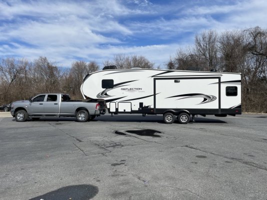

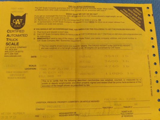

The most overlooked thing is Maximum Cargo Capacity or payload. It does not matter what the "towing capacity" is, you need to stay under max cargo weight. It is on the tire pressure label on the drivers door jamb. This is camper hitch or pin weight, fuel, passengers, dogs, tools, and what ever else you put in the truck. I find most people pulling campers are under trucked. I pull an 11000 pound gross weight fifth wheel with a 2022 Ram 3500 Cummins. My max payload is 3980, the loaded camper pin weight is 1880 pounds (CAT Scale weight). Add fuel, passengers, dogs and all the other stuff in the truck - probably another 1000/1200 pound, I still have close to 1000 pounds to go before reaching capacity. Hope this helps!
BTW - the 3500 was less than $1000.00 more than a 2500, except I went with the High Output engine and Aisin trans. Here's my Cat Scale numbers with fifth wheel and without. The truck was loaded with full fuel, 2 passengers, 2 dogs, firewood, 2 3300 watt generators, 2 1/2 gallon can of gas, many tools, spare oil, 2 1/2 gallons water for the dogs, and the other typical crap. Camper (2023 Grand Design Reflection 150 Series 295RL 32'9") is fully loaded including approximately 30 gallons water, 20 gallons in black tank, and 40 gallons in grey tanks. Pin weight calculates out to 1880 pounds (advertised is 1434), camper weight calculates to 10680 pounds (gross is 11000 pounds).
