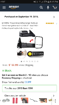

I purchased a set of EECCP tow mirrors off amazon for 200 dollars, i was very nervous the wouldn't have the ambient temp sensor but they did, they fit perfect and install took 15 mins each. Only thing I had to do the inside mounting bolt stuck out a little to much so I trimmed it. Great mirrors,
I actually wired my mirrors up as clearence lights instead of having the truck flashed for blinker signals, personal preference. Looks really cool at night they come on with my head lights.

Any tips on wiring for running lights? I have the same set and plan to do this eventually. They are a nice aftermarket mirror.
Tpearson515
Jul 12, 2016
218
79
Saco, Maine
I ran one single power wires from a relay pulled in from the PCM clearence light fuse (fuse box) grounded it on the studs where the mirror mounts,
Biggest issue I had, and once I figured it out it was very easy, running the wire through the door jam there is a plug you have to run the wire you use through not around.
Wire loom all wires, heat shrink connectors and fused the power wire.
I got a lot of my information from this forum and pieced it all together my own way
