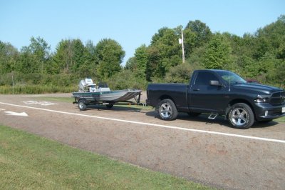

S7300303.JPG thank-you kindly for the feedback I'll try it,,,Addicted2fishing

Nice boat! That’s thing must fly with that motor!
