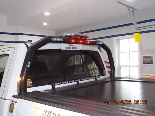

Had to modified the Tyger Sports Bar itself using a local welder. My 2018 Ram 1500 came equipped with RamBox so this Bar will not worked. Local welder welded 2, 1 at each bottom end 2.5" mounts cut from the other parts of the bar so the bar could be bolted to the bed. Lights include 4 Tomar Emergency LED lights, 2 LED turn/brake lights & 5 marker LED lights, 3 Red & 2 Amber. I painted the bar Gloss Black. Bar does not block third brake light.
