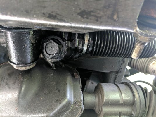

Look at the top of the rack where the power steering lines screw in. Check the connection and the hoses for leaking. In not leaking there the rack seal inside the boot is leaking. If that is leaking the rack will have to be replaced.
