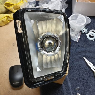

I read in a Chrysler release that the reason they changed the fogs on the '13+ was to increase lens area... I don't believe they're smaller, but I may be wrong.
I'd just like to know what bulb they use to see if I can get something different in there.
Sylvania doesn't have that info yet.
Chris
0212353
Vendor
Jun 29, 2010
26,460
2,029
Florissant, MO
2x 5.7L & 6.2L
They have a 9006 bulb in them.
They are physically larger, but.....there are some limitations to them on retrofitting. Mainly with the bracket they have on them.
With that said........
BAM!
Thats the Matchbox projectors in there, the Mini......oh so close to fitting. I mean, it "could", but the mounting would be a *****.....and these Matchboxes will do just fine in the fogs. ;)
If the dealer has a pass side, I could have a set of chromes ready to go this weekend. ;)
