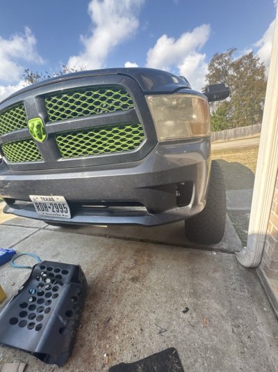

OK so I’m needing to replace a couple wiring harnesses and was wanting to know if anyone has done the same and where I can order them.
1) I pulled my fog lights out as they were not working so I was planning on replacing them and noticed one of the harnesses must have been grounding out and had started to melt where they plug in to the DS fog light assembly. Looking for either OEM or LED compatible as I’m not 100% sure which direction I’ll go yet.
2) The wiring harnesses for my headlights apparently got “ customized” from the previous owner, so I’m wanting to find out about replacing those as well. Same thing OEM or LED compatible.
