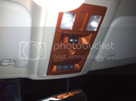

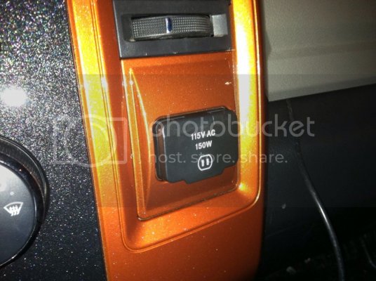

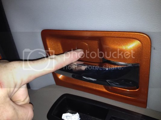

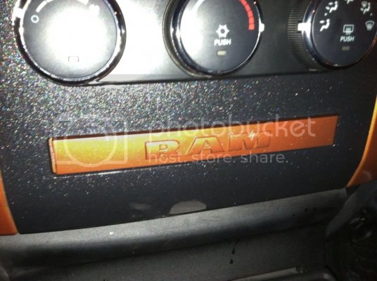

That looks pretty good, BO. I'm going to do the gauge cluster trim next. Did you actually paint the A/C vent shutters, too? How much of a ***** was that?
blackout11
May 23, 2011
4,000
453
alpharetts GA
2011 R/T
Was not to bad i had a separate set to practice on did the door handles to and the overhead piece
