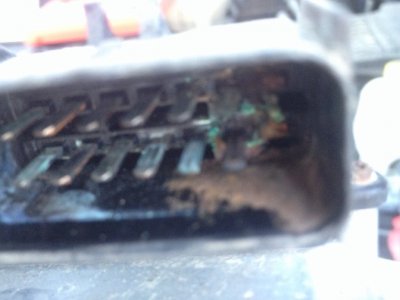

I'm battling my own ABS and parking brake issues. Check your ABS module and the connectors going to them. Mine had corrosion so bad I'm having to get a salvaged ABS module and female connector to splice in.
ImageUploadedByTapatalk1424628061.849733.jpgImageUploadedByTapatalk1424628078.001671.jpg
Still a lot better than having the dealer do it!
Sent from San Antonio, Texas

]Mine were both clean and dry and I checked the fuses any other ideas?
