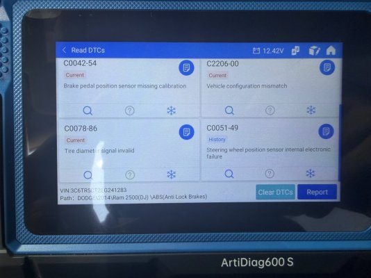

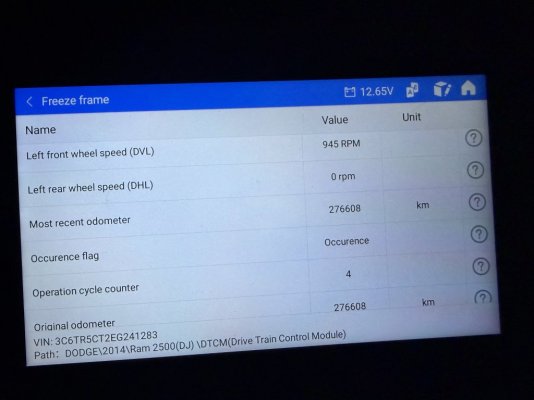

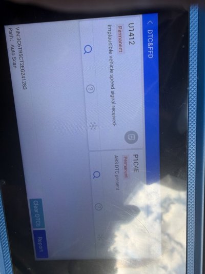

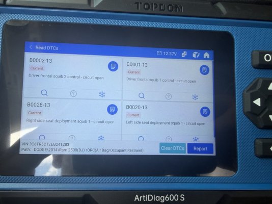

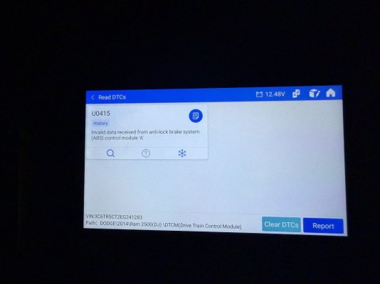

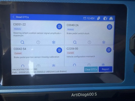

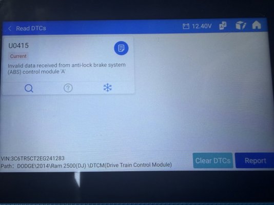

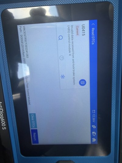

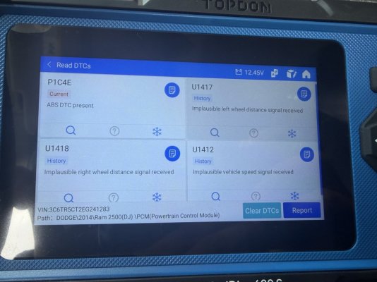

I’ve been having some trouble codes and I just can’t figure it out the culprit. I had previously installed an eBay radio. It was working fine but I decided to swapped my radio to my oem , my abs light came on / traction control , speedometer went off ,brake trailer warning , park assistant disable .I had some U canbus code, I clear them and now I’m having U0415 - C2206 P1C4E , my traction control came on too , my speedometer is reading again but blinking
/bipping with ABS icon on dash , my trailer is working again and parking sensors .

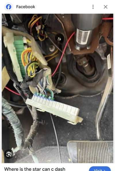

When I pull codes , it says transmission module not available . I have tested the resistance on wheel speed sensors and they are good . I have cleaned the switch round connector that goes in the transmission , I have cleaned the ABS module and it seems Ok . I did checked the IHS canbus module and when I unplugged connector 3 , it reads 0 omhs in voltímeter ( white / gray cable ) thru pin 3 and 11 ..thoughts ? Bad ground somewhere maybe ?
Ram 2500 2014 5.7
Note : I have know my clock spring is shot but wasn’t having this problems at that time .

If everything was working fine, you replaced the radio, and now you have all of these issues.....it's most likely something that you did when replacing the radio. Since you have to pull apart the center dash and messing with wires and cables there is a chance you accidentally knocked something loose. I would also check all the fuses and make sure you didn't blow one when plugging in wires and such. I would go back through your work and check everything out. Probably pull the dash again and look around where you were working.
A bad ground is a very good possibility as it would affect many different unrelated systems. A wiring diagram can be helpful. You can track down how all of those components are connected.
