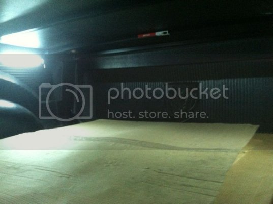

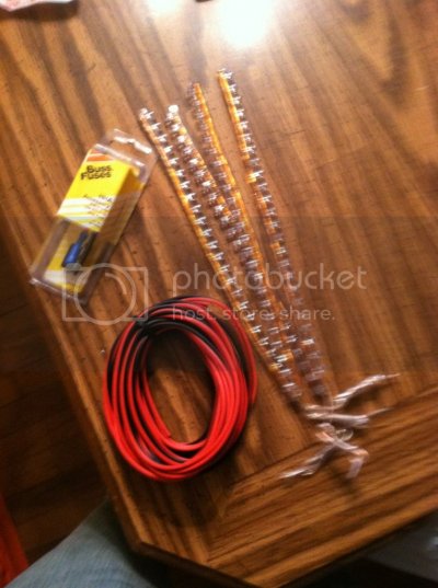

I bought a bunch of LED strips of eBay, they were $1.50 for a 10" strip
I spliced into the 12v accessory wire on the 7pin hitch reciever for pure and ran an inline fuse up through the stake holes to a switch just inside the bed
The blob of electrical tap on the left is the t tap lol
The wiring will look different the most 4th gens cause my dad has a T connector between the factory 7pin plug and the bumper that gives him an extra 4 pin for his LED bar
It's just double sided taped to the top edge of the bedliner because the pins for the rail caps make it hard to position under the rail, we'll see how they hold up
He had to go somewhere so I'll be running power to the other lights and cleaning stuff up tommorow hopefully

I didn't plan out my dads very well so it took me longer then it should have
I bought 40ft (supposed to be) of wire and was about a foot and a half short

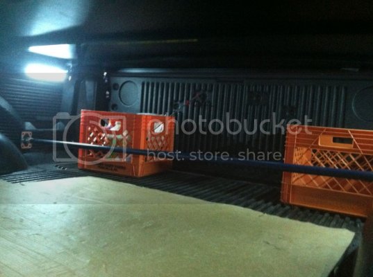

They're really bright though, here's with the tailgate and tonneau shut
Had my dad crawl in to see haha
