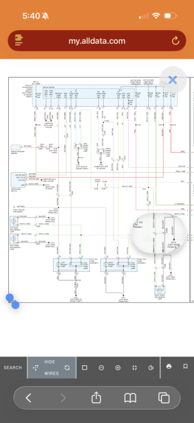

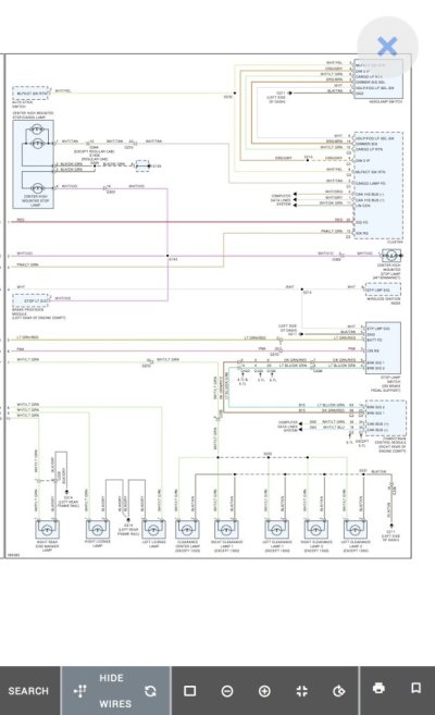

Hears a head scratcher, 2012 ram 6.7 when you turn the ignition on the rear tail lights come on. Noticed nothing came out of the third break lights found blown bulbs so I ended up just getting a new led one hoping that would solve the issue, nope. Figured for sure it was the break switch so I ran to the local auto parts and picked one up ofc that’s not the issue either, I pulled up a diagram and pulled all the fuses related only fuse that makes the lights go out is M20. This only happens when the ignition is on. I couldn’t fine much info on this online and the ones I did it was either the cab light or break switch. What are your thoughts?

Also the only fuse that ***** the lights down is m20 and that on the diagram just goes to the upper back switch so what does that have to do with my lights?
There is no way I can know without having my own source for that diagram, because the image is such low resolution that I can't see what anything on it says.

Problem solved, I went back to the main source the break switch, made sure the new one was working properly with a ohh meter it was so I tested the wires again because I know if the switch is unplugged or there’s an open circuit the break lights will come on. So for anyone else having this issue, with the ignition on
Pink: 12+
Red: 12+
Black and tan: ground
(Pretty self explanatory looking at a basic diagram)
Then there is the break signal wires that go to the PCM, after looking at the diagram and connector veiws I was able to trace the signal wires (blue and green wire with red stripe) to the right side of dash under the kick panel, there is a grey 10 pin plug, there I found a bad connection between the signal wires. After the repair the lights went off ended up being a pretty easy fix.
