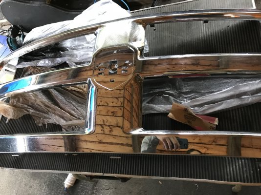

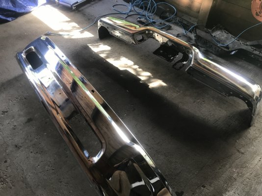

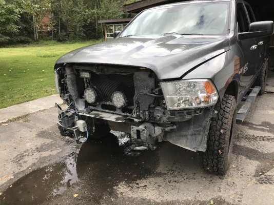

Remove all the stuff so you get to this point here and see a truck that looks like it got curb stomped

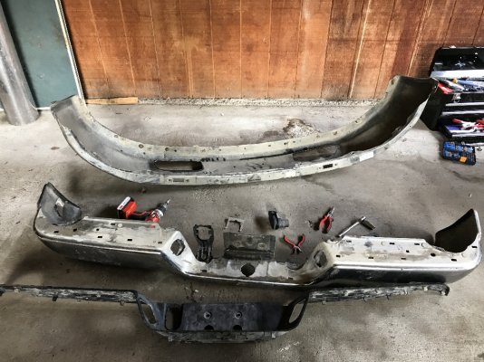

Start removing all the brackets and end pieces from the bumpers, the trailer plug is simple snaps that push in and the plug pops out the license plate side. The license plate lights have a metal frame slide (not sure what its called) that you just pull out and the light drops out, it'll make sense once you get there. To remove the plastic step cover, I used a panel puller and a pair of pliers to pinch the tabs underneath and the panel puller to pry it off. This is about what it should look like after:
Wash both bumpers with some good dish soap to remove any dirt (yes, wash twice). Do a quick wipe with a towel, and then spray with the degreaser of your choice. I chose the Industrial degreaser from Lowes and it worked great, again, a mask or respirator along with eye protection is recommended but work at your own risk!
Get your area staged and prepped, I had a nice Orbital Sander so dust was not an issue but make sure you have enough space to move around.

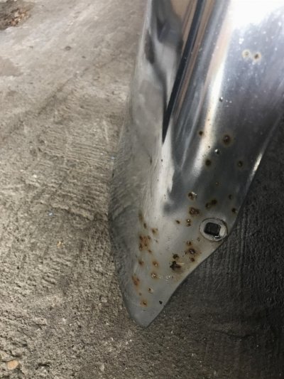

If you have any rust, make sure it is completely gone otherwise it'll come back with a vengeance. aNO7JPb.jpg

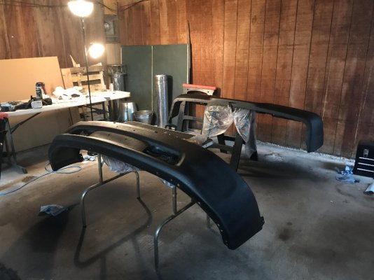

Time to paint:

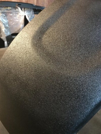

First layer should be relatively thin but make sure you get a good coverage. It's okay to see some metal behind but make sure its uniform. I wasnt as careful on my rear bumper and ended up with some tiger stripping. I was able to smooth it out in the next couple layers but I made more work for myself than necessary ftryNdK.jpg
The liner has a 20 minute interval between coats. I started with the rear bumper, set a timer and started on the front. Once the front had a coat, set a different timer, and I had about 7 minutes to grab a beer. Make sure you set up your bumpers in a way that allows you to hit all the angles, especially the corners. I found those the most difficult to reach but pay special attention otherwise you might get flaking. cZsqpa1.jpg
While curing:
Allow bumpers to cure over night before re-installing.

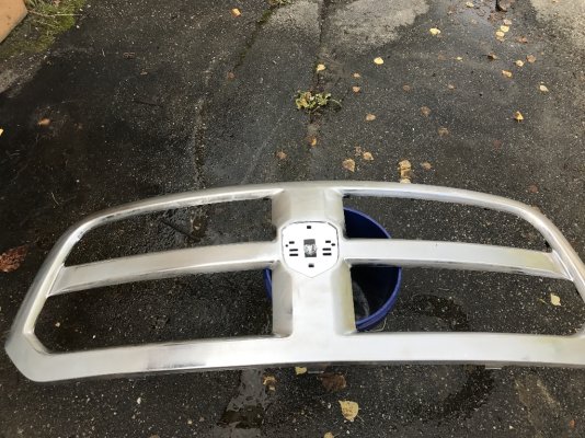

Start sanding until you get clean dull finish. These are plastic so be mindful not to go too far. I spent a ton of time sanding to make sure it would adhere well since I wasnt sure how this stuff works on plastic.
Before sanding: L9xDnF1.jpg
After sanding: I886JLb.jpg
AGAIN, IMPORTANT: de grease after sanding to remove any dust.

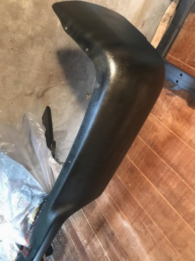

This is after the 3rd and final coat but not dried yet:
Make sure you let it cure overnight BEFORE putting the emblem back in. I opted to not put any more adhesive tape in there, i feel the 4 tabs did a fine job securing it so I skipped it. It was raining the next day so had some pretty flat light but I think it turned out excellent! Been about 2 days and had 3 people ask where I got it done... did it myself sucka!!!!!
the left of the bumper is runoff from rain and dirt puddles, it is NOT streaky when its clean. The nice thing is that I just hosed off the dirt and came right off. The water seems to bead right off the finish, here to hoping that lasts! :favorites13:
