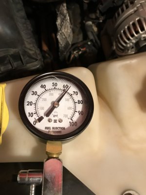

It’s still cutting out with the tow haul on. Real bummer. Driving back home tonight into the wind in tow haul it cut out pretty rough about 50 Times. I checked the fuel pressure on the new pump just to make sure and it’s good. Probably transmission/torque converter or electrical related to the two I’m guessing. Possibly the lock up converter hammering in and out or maybe the transmission going into 2 gears at a time for a fraction of a second.
Any history of this on other Dodge Rams?
I’m going to check PCM connections and transmission connections.

Strong fuel pressure when pulling into the garage after cutting out
