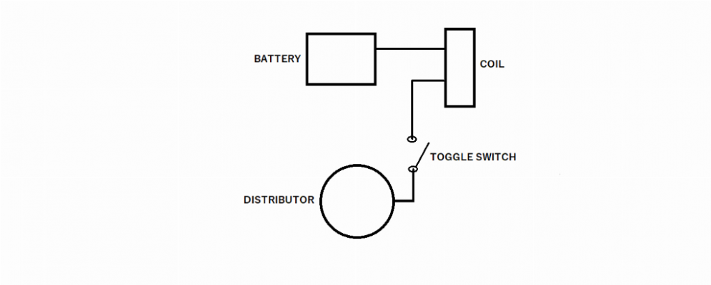

I want to install a kill switch on my 02 RAM but finding a color coded wiring diagram is a problem. The last kill switch I installed was on my 74 C20 454 and it was simple but I'm a bit apprehensive on messing with the wiring on a computer controlled vehicle.
The image below is obviously not for a modern vehicle, can someone point me in the right direction or share their knowledge on this subject?

If your looking for anti theft id go with the fuel pump cut off. Constantly disconnecting the battery on computer controlled vehicle that stores driving data to perform at peak isnt good

Not sure about the Ram, but I had an 02 Dakota and learned that the automatic equipped trucks also had wiring in place for a clutch switch. You could simply put the clutch safety switch wiring on a hidden toggle which would prevent the starter from engaging unless this switch was on. Could also be a momentary switch...
