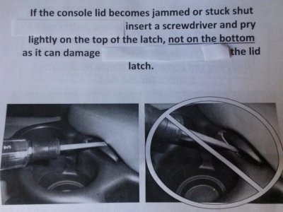

My son slammed my center console lid closed and now its jammed shut. Any advice on getting it open without breaking latch assembly. Thanks

Lid jammed
I called A friend at the dealer and he found this photo and E-MAILED it to me. I guess it HAS happened to others? I worked great
